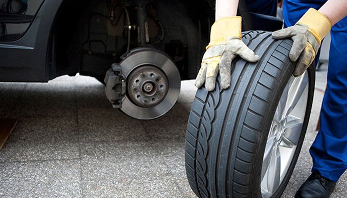

Tires
It is equally important to check the condition of the tires, as air may leak due to even the slightest leak. For example, the tire can be run down by a poor and loose fit of the tire to the wheel rim, an inoperative tire valve, a microscopic tire puncture that is not visible at first glance, or a crack in the rubber. If you don’t take care of this in advance, then after a couple of weeks of parking in the garage, the car may “sit on the wheel”. And long standing on flat wheels can lead to trouble in the future. for good. This is especially true for passenger cars, they may cracks during long standing on the rim of the wheels in the tires and the cord may even delaminate. If this can be avoided, then the geometry of the wheel may be violated, the so-called "eight" appears.

Brake system
When the car is on a joke, the brake discs may become rusty due to environmental influences. Even one night parking can cause the appearance of small red spots. What can I say about the long idle time, in such a situation the discs may completely rust. It is also worth remembering that when Since the car is standing for weeks without moving on the handbrake, the effect of “welding” brake pads to the discs or souring the calipers may be observed.

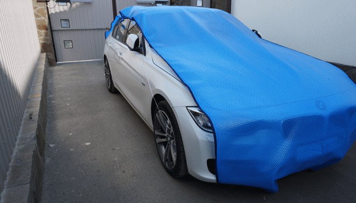

Car radiators do not like long downtime. Standing outside may cause the radiator to become clogged as particles of dust and debris get into it. Often city sweepers sweep sand and flush street dirt directly onto cars parked in the immediate vicinity. A car, which will be in the garage for a long time, is not insured against dust. But you can cope with this problem if you take care of purchasing a special protective cover or tent in advance. It will not allow dust to sink into the radiator.

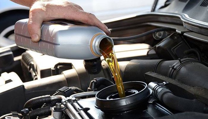

Oil and technical fluids
It is important to check the tightness of the system and the oil level. If everything is in order and there is no leak, then the car can stand without losses for more than one month. Oil and gasoline, of course, evaporate, but very slowly, especially while the temperature outside is quite moderate. Therefore, serviceable cars can be safely put in the garage for a long parking.

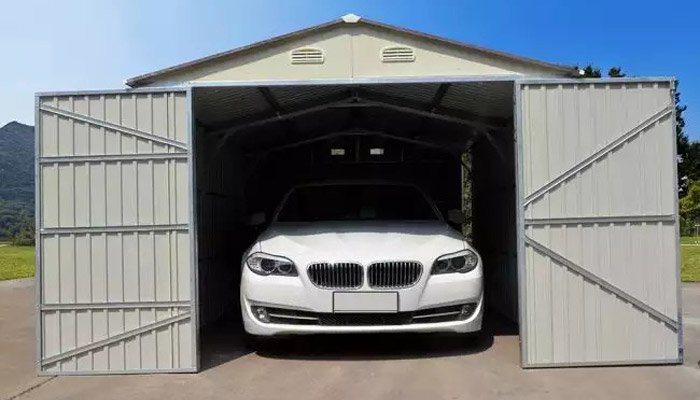

If, however, there is sometimes no opportunity to engage in a machine, we recommend preserving it. For this purpose, a garage or at least a closed parking lot is best suited.
